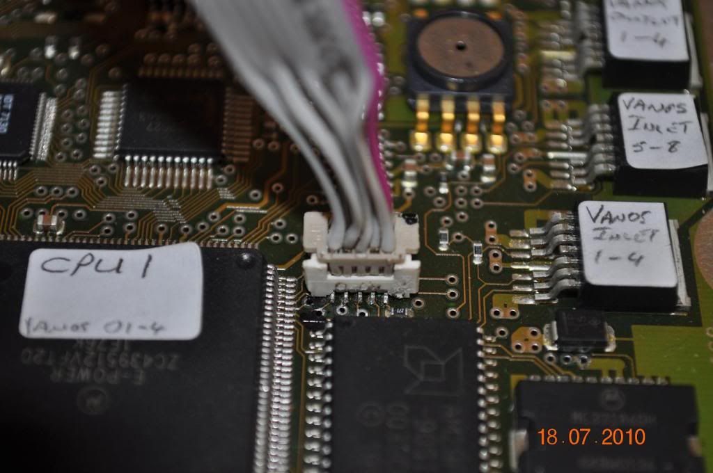

    Nov 2009
    47
    2 Posts

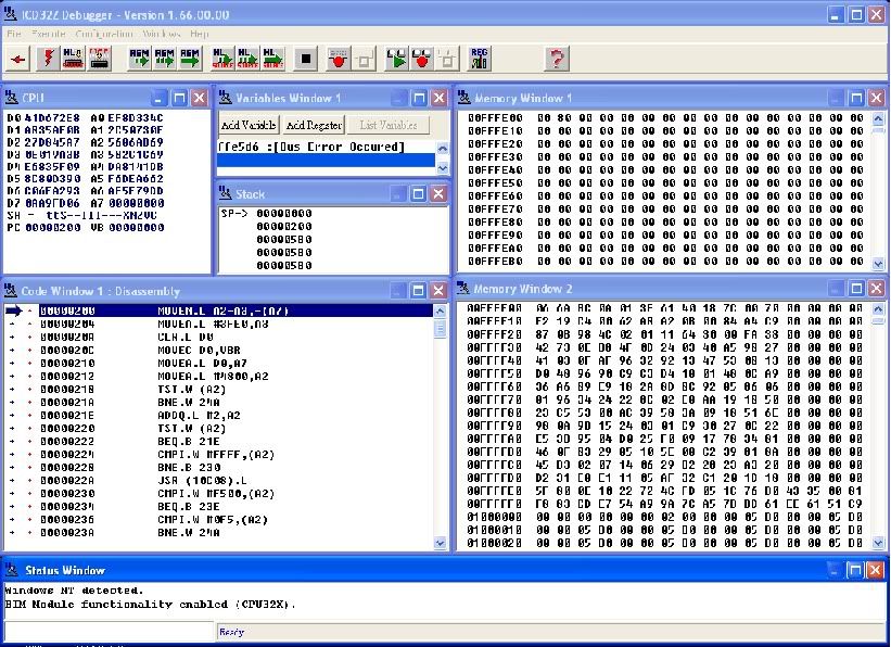

    First we correct the bytes on a 16bit boundry to get the BIGENDIAN format for the Motorolla protocol.
    We disassemble with Motorolla 68330 as CPU choice.

    From the above documentation we can see that the Initial Stack Pointer is set to zero and that the Initial Program Counter shows to dc.l loc_200

    An update of where I am at the moment..
    I have connected the Wiggler BDM interface to the ECU and at first I used the for free OCD commander supplied on Macraigor site. The debugger works perfectly but I found that I needed more information, I guess I am still spoiled by the windows debuggers.. Next I searched for software that could work with the wiggler interface, it seems like there are not many options, the one I chose to use at the moment is the ICD32Z debugger program. This program shows all the registers, one can monitor the memory area and single step or step till a given address. The program lacks a few functions which would be nice to have but for the price I am happy for now, again, if I need more I have to pay more.
    The code seen in the debugger is exactly what I expected to see because this is the code that IDA showed as well. This code in the debugger also ties in with my explanations of the vector tables and entry point in the program posted earlier in this thread.
    I have bought a digital oscilloscope to monitor the sensors on the engine. My ultimate goal still is to simulate the sensors to have a bench setup of a "running engine". Here are two pics of the crankshaft sensor and the exhaust camshaft position sensor. One can see on the crankshaft that the pulse train is 60 pulses per rotation with a position pulse missing at 60 to indicate TDC.

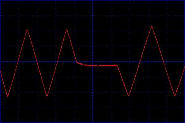

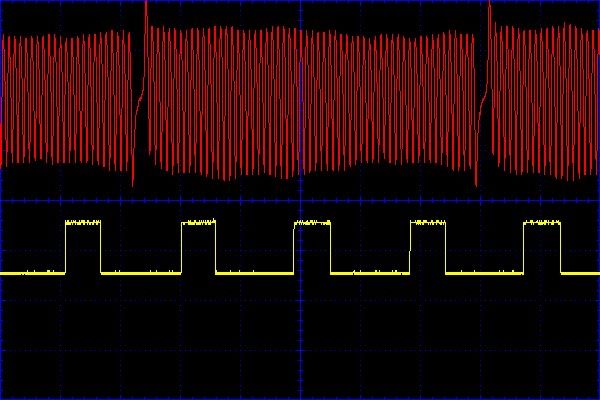

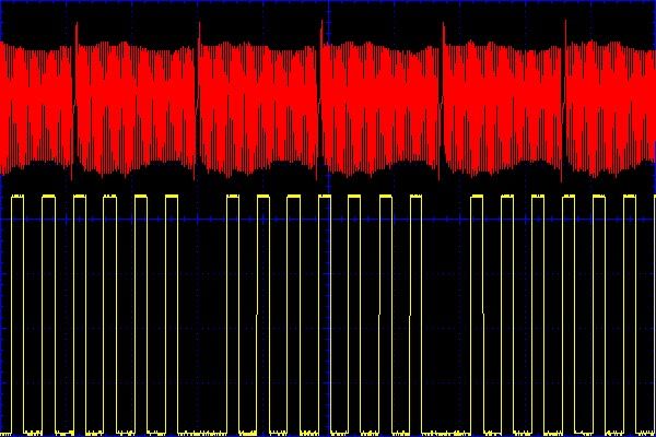

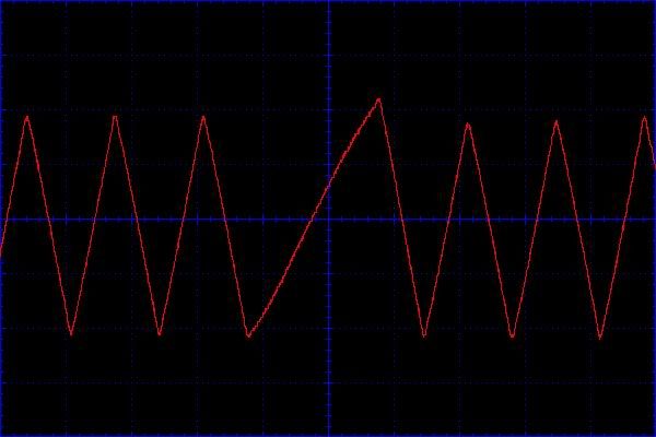

    Hi guys
    I have used the CrankWheelPulser utility to create the pulse train and boosted the voltage level through a normal desktop speaker system to 9Volts. I still cannot see the RPM values in INPA. I have connected a temperature sensor on the bench DME and can see the ambient temperature in INPA. I do not know yet why the RPM does not show in INPA. I have tried to modify the pulse signal as follows but still no luck.
    Zero pulse as created by crankwheelpulser:
    Pulse modified with audacity:
    The DME does see the pulse train because as soon as I switch the pulse train on the fuel pump switch on and stays on until I switch the pulse train off.
    I have also received my BDM connector and soldered it on CPU1 side.
    I have traced the code until I found the place where the fuel pump gets switched on.
