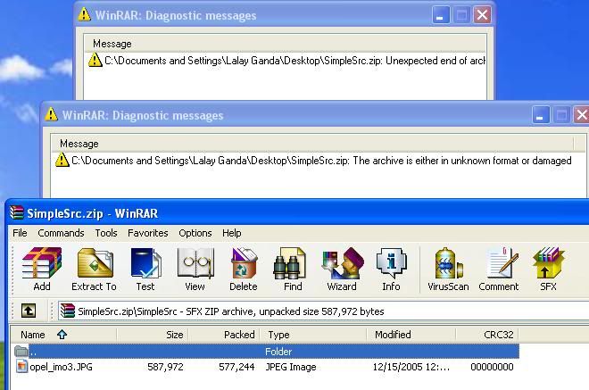

    Please upload in RAR there is a problem on ZIP file in this board

    I think there is a Problem, I still cannot open the attachment
    if anybody can compile the attached script for me and post the *.XSCR file please help
    I just want to know if the problem is about my PC or a bug from the software
    Thanks in advance

    The problem is not about the player, its abou the extracting ofdownloaded files. any zip attached on this forum, I cannot extract it, but rar files can be (see attached pictures from previous)
    anyway the problem from compiling was solved, it is an issue about some apps installed in my computer.
