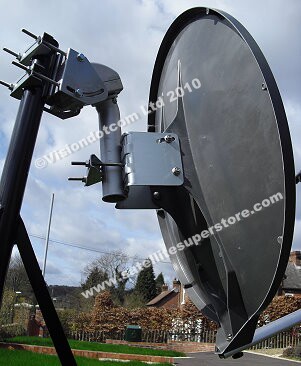

    got my motorised dish up and manually ligned up to 28E for free sky channels works great, but then cpl o days later tried settin it up to use the motor (tm2600 hooked upto tm600) but i have to admit i got no idea wot im doin (totally out my depth ) but will keep tryin am sure i'll get there (probably when i'm 6 feet under)

    thanks already looked at that b4 and didnt help gonna have another shot at it 2day good juob i have my hair shaved

    hello mate have a look at this guide its a quick guide for std TMs but may still help with your tm600 using the sat finder menu its just the menus I refer to will be different, but if you already have 28.2E the rest should be easy the biggest thing is to get the pole 100% plumb and input your location latitude the same in the set and on the motor you can leave longitude at 0.0 to start with and fine tune it afterwards.

    quick question guys the instruction book with my tm2600 motor shows the motor and then the rotating pole pointing in a downwards direction but i was lookin at something i found online and its the opposite way ie the pole points upwards my question is which is right oh and heres the thing online i was lookin at http://www.stab-italia.com/pdf/usals/en.pdf
    Dec 2008
    5,117
    6
    6 Posts
    Points down on TM2600
