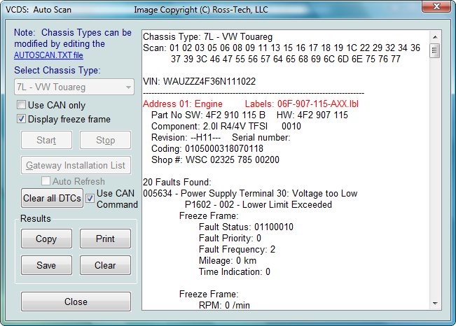

    I bought from China vag com 908 for my Seat Leon EDC16 2008, unfortunately I can only use the form on the Engine (Module 1), while others do not! when I do the tests tell me "CAN: Not Ready", how can I do? Help me

    do an autoscan and see what controllers it finds

    Autoscan makes the program (vag-com/vcds) look for installed controllers in the specific car.Phen opening the program from your short cut on the desktop you should be able to see a button on the main screen just saying "autoscan". Push this one.
    "Can not raedy" will usually come up when the car doesn't use this protocol, use the "test" function from options, in the main screen as well. What protocol is shown when you enter in engines? 2008 should be can, but.... where do you live'

    I have seen this many times before. Vehicle uses Can, but the engine (and the automatic gearbox if present) also has the K-line still connected for EOBD communications.
    You need to buy a new cable WITH Can this time.

    If you are an Engineer than how come you could not figure out how to use Auto-Scan option ?
    Now for your information when you test the Vag-com cable on an vehicle which is NOT using Can System it will always tell you Can NOT Ready.
    So the best thing is to do Auto-Scan and see if it will connect with which module.

    I have to do the autoscan and the message is "the car required Can Line, the gateway do not supported"

    I have to do an Autoscan and and the message is "the car required Can Line, the gateway do not supported"

    You need to buy a NEW cable WITH Can.
    Or if you are in a hurry take the car to someone with the right cable like the dealer.
