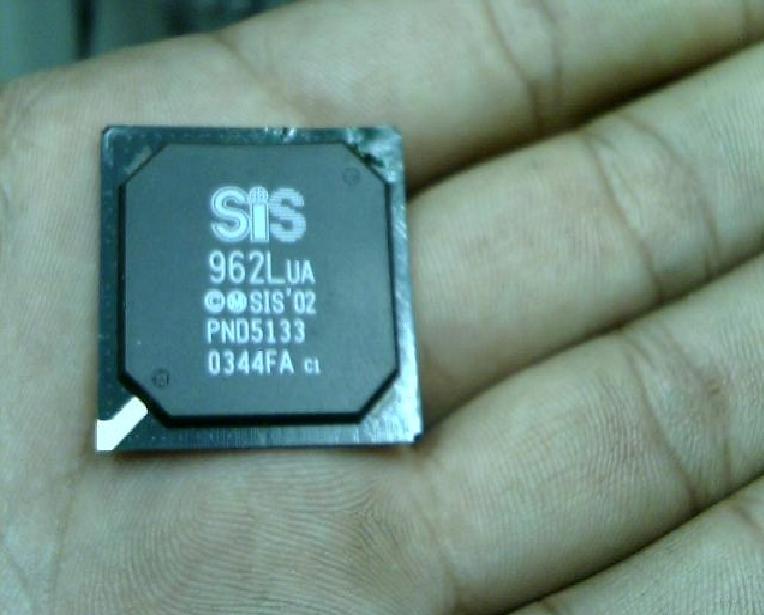

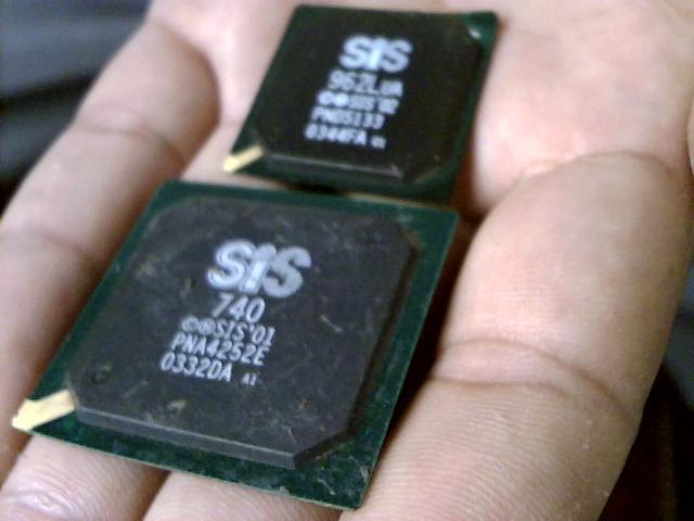

i find desolder the 2nd processore more easy than the first
may be the 3rd one will be d?solder and resoldere with succes
