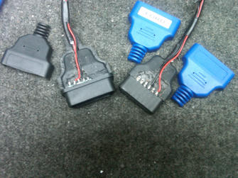

    cotymoto i allready say what ford cable clone pin 7 no conection so try to repair and wen try to chek whit multimeter
    obd2 female 4 obd2 male 4
    5 5
    6 3
    7 7
    14 11
    16 16
    i had no conection on pin 7 to 7 so add wire outside adapter

  15. #1455
    audiotek's Avatar
    May 2011
    626
    220
    800
    183 Posts
    Quote Originally Posted by scary View Post
    FORD FOCUS 2006+ by OBDII diagnostic (CarProg Ford additional adapter required) a1 + ford
    Thanks for the tip, I tested my carprog clone FORD cable and there is no connection between the pins 5 - 5 and 7 - 7.
    Repaired now, I'll test and comment.
    Here is a picture of cable repaired:
