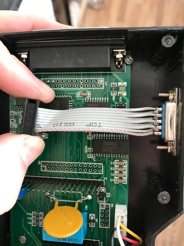

    can anyone here help me by providing the wiring pinouts for a tachopro 2008 9pin serial port, as all the clones dont have this wired up and i would like to wire mine up so i can save dumps onto my pc.

    could you post a picture of the wiring for the serial port so i can wire mine up please if its not too much trouble

    cheers alex but i have the null-modem cable but the connector is not wired to the board inside the unit, this is what i need the details of

    so you actualy need connection inside Tacho Universal unit?
    From connector to TU PCB ?

    yes alex thats what i need

    But old like but may come in handy
    http://i27.photobucket.com/albums/c1...psvpr79sg1.jpg

    So looking at the board holes
    bottom right is a square
    so from square going up
    square pin 1 of db9
    going up to 2-3-4-5
    opposite square going up is
    6-7-8-9 top being empty
    hope you can follow this
    old news but just needed it myself for an old KA dash
