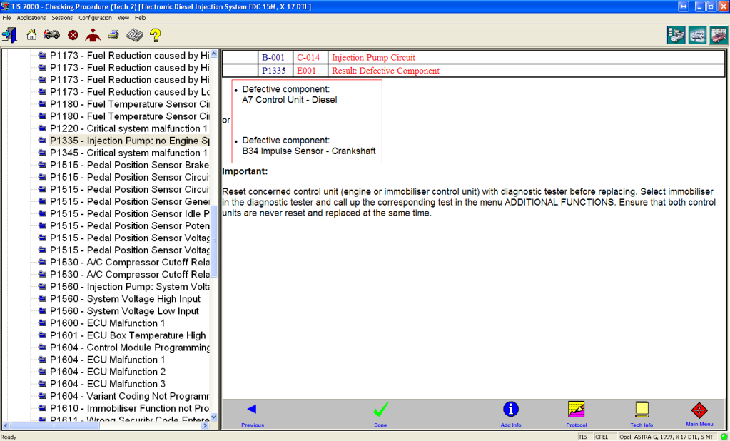

    Hi, does anybody has problem with this error :
    P1335 (A) Injection Pump: no engine speed input signal from control unit.
    Car starts hardly , sometime it starts 5-10 times without any problem and no error if I starting without delay.....
    after 1 minute if I try to start I got error and starts hardly, but second strt without delay starts ok ...????? any idea ???
    All wiring ECU <=> pump, ECU<=> CPS ok tested
    Crankshaft sensor from good running car
    Pump electronic head from running car
    On scan I have good signal from pump and crankshaft
    injectors ok

    Check rpm and pump speed in live data. I think pump speed is 1/2 engine rpm.
    A part of the electrical circuit is inside the engine ecu. That can also be defective.

    NEW ECU and still same problem
    So:
    1 NEW ecu
    2 new CPS sensor
    3 new pump electronic
    4 checked, all wires ok
    5 new injectors...
    ANY idea ??????
