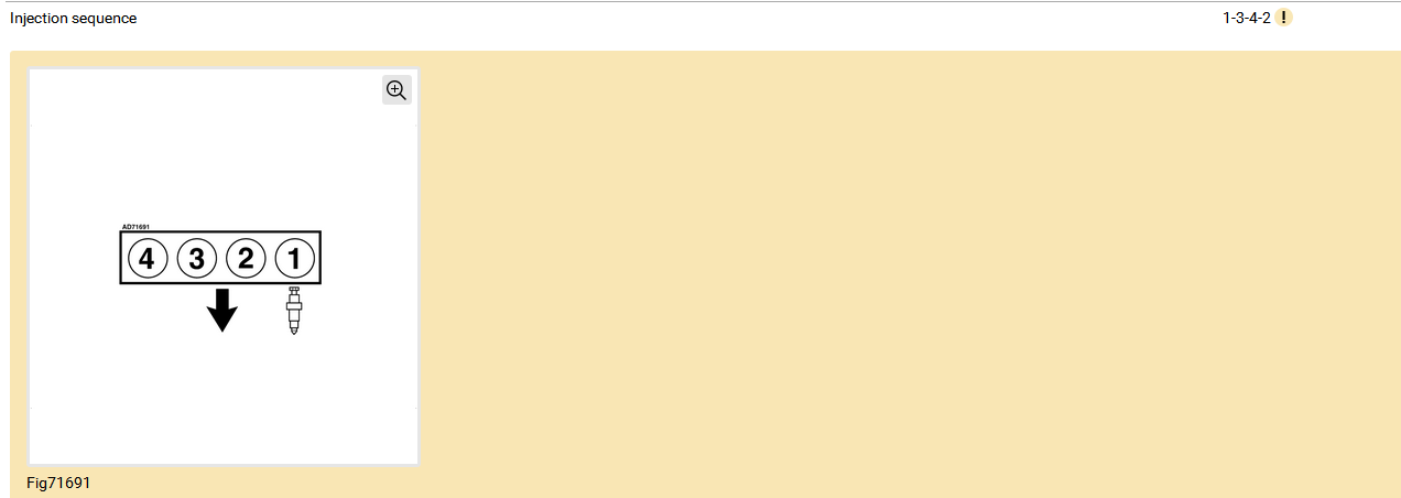

    The injectors in my car have previously been marked to each cylinder ie: 1 2 3 4
    Cylinder 1: 7RHR4F
    Cylinder 2: BTHUE6
    Cylinder 3:
    8R1BR1 looks like a one but some say its an I
    Cylinder 4:
    AAHWB0
    Do the above codes sound correct and what i would need to enter ?
    He used PCW or Precision code works CMDFlash BDM for the ECU Reading and then tried AutoCom / Delphi to reenter the injector codes but was having none of it
    If i purchased the CAN Clip would that allow me to enter the codes ok ? as the injectors have them 6 digits them string of numbers like a serial below
    have been like this since last wednesday
    thanks again
    Chris.

    just to also confirm if this is the correct order for the injectors
    1 is marked timing belt side then 2 then 3 then 4 is gearbox side as they have tipex on the sides from 1 to 4 ?

    4321 1 is gearbox end

    so the codes should go as followed
    Cylinder 1 = AAHWB0
    Cylinder 2 = 8R1B81
    Cylinder 3 = BTHUE6
    Cylinder 4 = 7RHR4F
    and not the way i had them ?
    Thanks again.

    yea what ever is written on injector 1 (flywheel side) write that in box cylinder 1 in what ever program you use and so on
