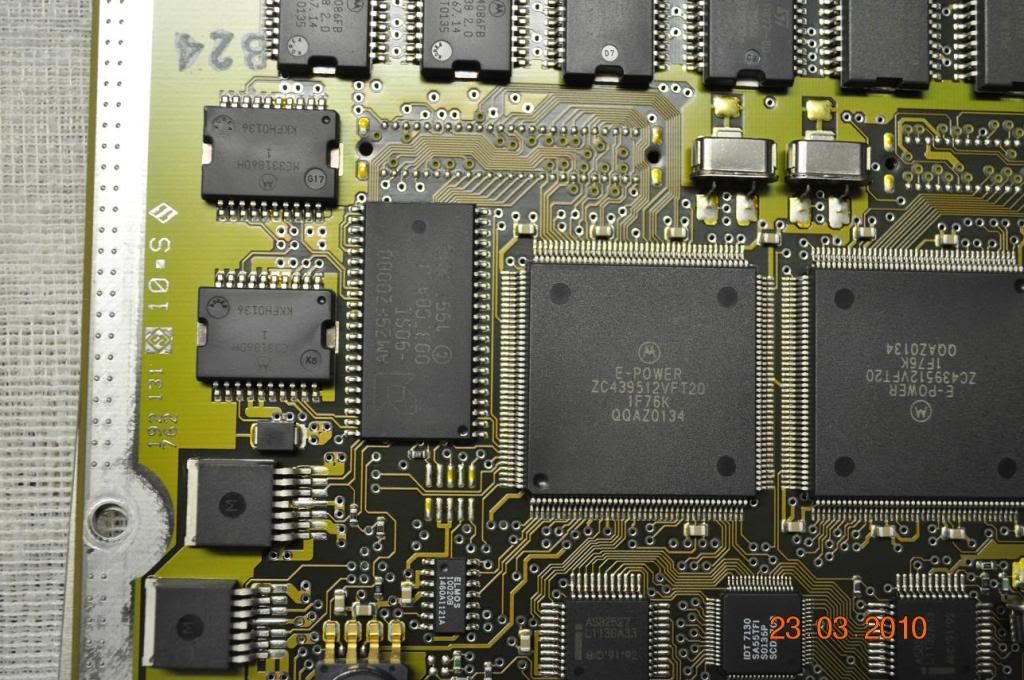

    The DME I have does not have the BDM port soldered on the pc board so I have to solder the wires on the chip pins, but it should not be a problem as this is my test DME, I will post pics of my setup as soon as I receive my DME.

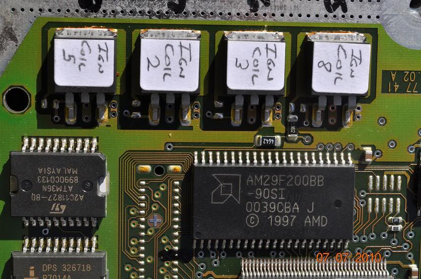

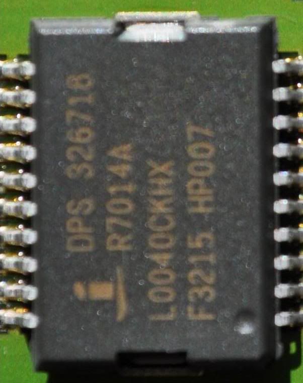

    Default IC's identify please?
    Hi guys
    I need some help to identify some chips please. I have searched the internet and can find the model numbers but I can not find any data sheets for the chips.

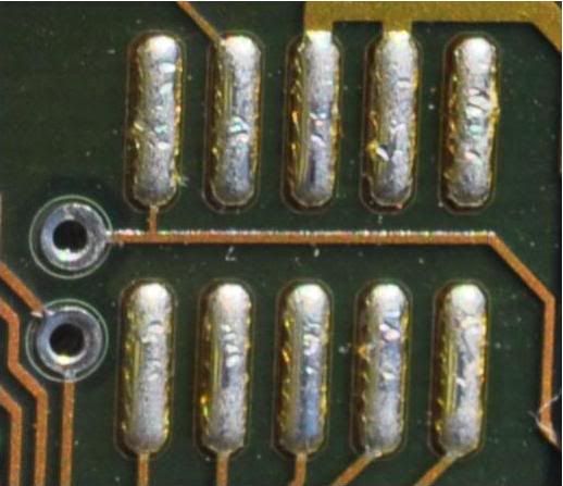

    Interesting as well is the BDM connector tracks that is on the board, below is the detail picture, I have ordered two plugs that will fit on this tracks and are still waiting for the hardware, will post pictures once I receive the plugs, on the picture below the tracks can be seen next to the memory chips:

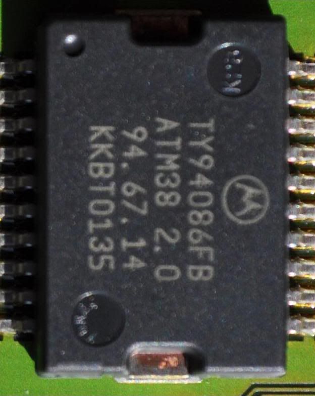

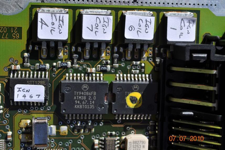

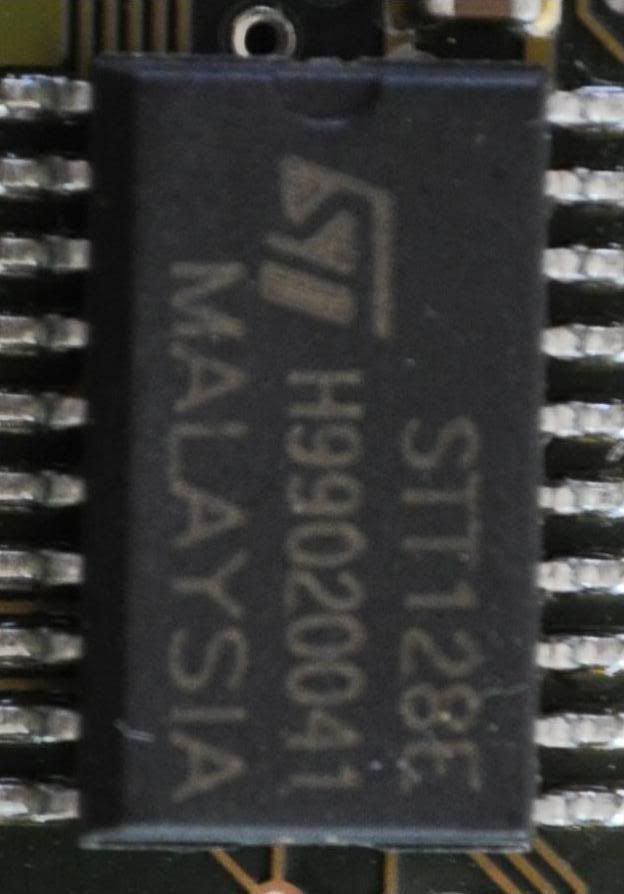

    Here are pics of the Ignition drivers as well as the driver chip for the driver ic's, one driver chip is on the front of the pc board and the other on the back:
    Below are three pictures of driver IC's that I would like to have data sheets for please if any of you can help I will appreciate it very much.
    Cheers

    Do you have another module the same? If so try desoldering the chips. Sometimes the manufacturer mumbers are on the underside. I would assume that these are driver chips for whatever transmission protocol the unit uses. K-line, can bus etc.
