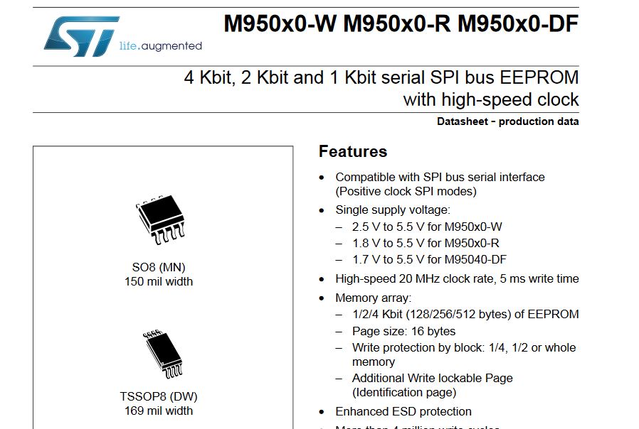

    Does anyone know what is the position of the socket to read an eeprom spi for the orange5 programmer?
    i need read a eeprom 95020

    I use like this..........
    Or if eeprom no simpel get.

    TSSOP8 and SO8 have same pinout?

    msopt tssop is same pin out

    Well i have a Clio Mio 2014 with dash Magnetti Marelli have a X5020 TSSOP8 (X= I can not see the first number this blur).
    I try to read it and nothing, check connections and welds and they're fine.
    I try a 95160 SO8 and if I can read it and burn it.
    someone had this problem?

    Hi..
    Is adapter of 0.65 m
    https://m.ebay.ie/itm/MSOP8-to-DIP8-...EAAOSw7p1aochj
    Or use pin out.. use botton search RENAULT LOGAN.SANDERO 25C020
    to read some EEPROM in circuit the voltage should be lower...
    4.7 adapter.
    Incircuit of 2.5 to 3.7v

    Well I bought the TSSOP8 adapter and finally I could read it.
    Dash: Magneti Marelli 24810 8959 R
    eeprom: X5020 TSSOP8 (X= I can not see the first number this blur).
    original mileage 94845km
    need: 41200km

    Mileage in file.
    0xc0 ~ 0ff...
    Tachosoff 2.31
    Renault sandero 95020
    41200 = 80A974027F568BFD

    Since you are interested in knowing how the orange5 script works; I leave you some info and when I can I do the script and I publish it
    41200 * 1000 = 41200000
    41200000 toHex = 02 74 A9 80
    02 74 A9 80 Swap = 80 a9 74 02
    first 4 bytes 80 A9 74 02
    80 A9 74 02 xor FF FF FF FF = 7F 56 8B FD (last four Bytes)
