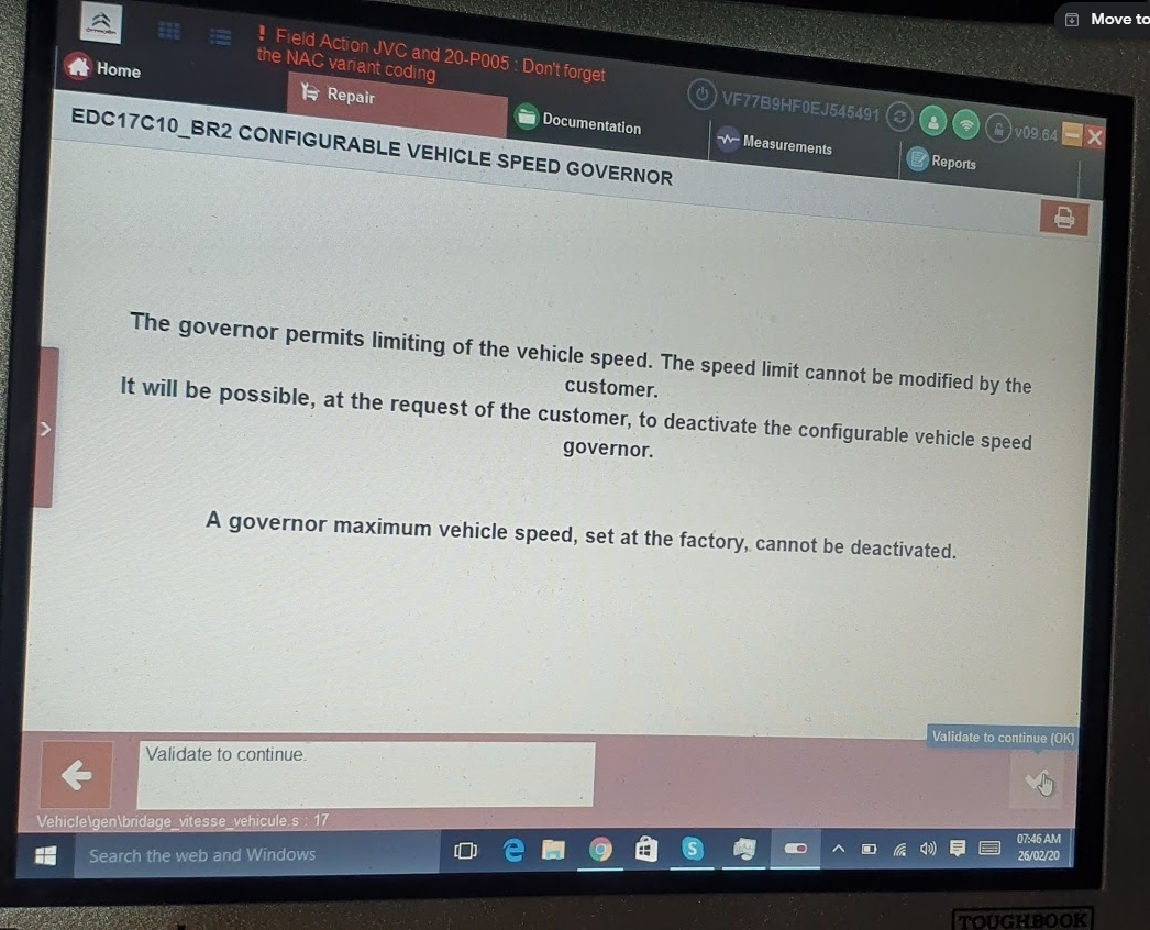

    Hey guys, i need to remove the speed limiter from a Citroen Berlingo 2011 1.6 hdi 55kW. Car is limited to 110 km/h. I have tryied to do it via DiagBox, but cannot be done, because it is asking for online subscription to PSA servers.
    Can it be done via ecu ? I am posting here a full read of car's engine ecu, and EDC17C09 if i remember ok.
    Thanks!

    sorry to jump in on his post , l had same car and even with online account cant change limiter
    can someone tell me if limiter was in file after all ? vans long gone but would be very interested to know, my file guy said it wasnt in file

    I was under the impression new bsi only

    You might be right , even citreon servicebox were no help in sorting it out

    Limiter in the file is 220kmh so isn't the problem.
    Shame there was no follow up to this thread as the use of the bypasses looks promising.
    The only thing I would double check is the addresses, from what I can tell those would deactivate RVV (cruise control) rather than LVV (speed limiter) but I might be wrong.
    303B35- VSCtl_bDeacIrvVSLim_C
    303B38- VSCtl_bDeacRvVSLim_C
    Just a passing thought as it's not really my subject, but it would be a shame to spend needlessly on BSI boxes.

    Tested, car runs exactly as before.
