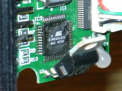

    Quote Originally Posted by eliotroyano View Post
    This is the message that I get when I test the interface, but it can not connect to the car. I also try with my old KKL cable and it work prefectly.
    Yesterday I check out my Vag10.6 clone interface and took some pics:
    I check out the 7805 regulator is getting really "HOT" and it is only showing 3V at it 5V output. Also that test was on bench too, connecting Power and Ground only. Led starts flashing red and after that it turns off. Something should be in short. Anyone have a electrical or schematic diagram of this interface. Some help could be useful.
    If you plugg it the 7805 has to have +12V (on OBD II side )-GND-+5V (LED side )
    - pin 1 (V in ) +12V
    - pin 2 GND
    - pin 3 ( V out ) +5.0V
    If it hasn't and become hot, change it
    Let me check it and I will let you informed.
    Thanks a lot,
    Change the 7805 regulator with a new one and I got the same result. When interface is cold led flash red almost 10 times, 7805 output is 5v and starts to drop to almost 3v and led flash red 10 times more when it turns off and 7805 is really hot and untouchable. If I let cold down half a minute it only flash red 8 or 10 times before led turns off. If reconnect power to interface just after test it, led flash red no more than 3 times before it turns off. In any case 7805 get really hot and voltage drop slowly until red more or less 3v.

    Quote Originally Posted by mattydr67 View Post
    I suppose that there it is short.
    Check pins and PCB wires
    Good luck
    Thanks for your support. But the weird thing is that I have used the cable in the past (last time was 2 months ago) and it work excellent. Now I try to use it and I got this issue. It can be kind of transistor damage or maybe atmega program issue?????

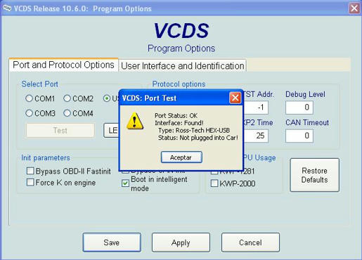

    Hey mate!
    You probably have a short, fried component or low impedance between tracks or pads.
    Post a print screen of the TEST result
    Good luck.

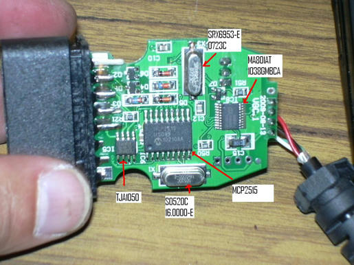

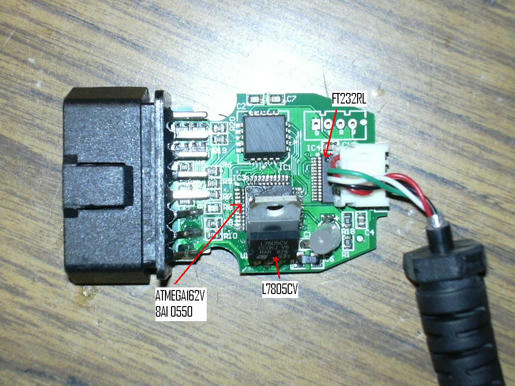

    Quote Originally Posted by KenshinPT View Post
    Hey mate!
    Good luck.
    Here are the pics KenshinPT.
    Thanks,
    If the interface was found, the UART-USB connection is OK. So FTDI is OK.
    Software or dump issues shouldn't cause hardware problems, like the one you have.
    To conclude, in my opinion, you have a defective component, short circuit or low impedance between pads or tracks...
    !!Check the whole PCB!!
    Thanks a lot for you help KenshinPT, but do you have some schematic of this interface to following it?. SMD transistors could connect directly to OBD2 & CAN lines then, my thought is that something else connected to +5V line is in short or low impedance. Could be ATMega162V, but at least it starts few seconds when Vcc is enough and after that it turns off due to low voltage.
