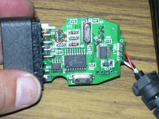

  11. #2876
    Aug 2009
    314
    13
    17
    12 Posts
    Exclamation
    Quote Originally Posted by KenshinPT View Post
    In your hardware, you have 4 transistor for KKL but those 2 transistor you're saying that your cable has, are in fact diodes
    Your hardware, have both chips for CAN (CAN controller and CAN Transceiver)
    And you're right, those 4 transistores could be in short.
    Good luck
    Regards.
    Well I pass almost all night checking and testing everything in the board.
    I check out the transistors and are ok!!!! Weird... but anyway.
    I found that K & L lines arrives up to these diodes:
    And continues to big signal diodes near these ones. After goes to the GAL16V8, I suppose this is the face erased IC. That contrast to the transistor diagram that you share me.
    I check out the whole pcb and re-pass every solder of the main components in the front face, GAL, ATMega and resistors and capacitors near it.
    With 7805 out resistance from +5V to GND is 2.5Kohms!!!!!!!!!.
    Now interface starts, LED blinks red all the time, 5v is stable, 7805 get hot but not as before and I notice that ATMEga and GAL get hot not as 7805 but more than should be. In fact I got almost 80?C of the 7805, almost 60?C from ATMega and 50?C from GAL. Transistors, diodes and ICs in the back are cold.
    Software still recognize interface but I got the following message:
    Also USBView recognize interface and MProg recognize FT232RL.
    Now I really confused!!!!

  14. #2879
    Apr 2010
    RF
    133
    39
    21 Posts
    Quote Originally Posted by eliotroyano View Post
    ...what could be wrong?????
    In the first, cease to load identical photos, or reduce their size.
    In the second, compare the diagram of your cable with datasheet a cable.
    Of the third be convinced that you didn't make errors when "tuning" cable.
    In the fourth, give a cable for repair to experts. It is very difficult to repair a cable if it is impossible to take it in hands.
    Try to replace the GAL chip with jumpers. Replace ?tmega. Check soldered details.
    I don't see in your photos, three jumpers which are necessary that the cable earned.

  15. #2880
    DK Veteran KenshinPT's Avatar
    Mar 2010
    PT
    408
    11
    23
    15 Posts
    Friends do you have any idea what could be wrong?????
    I know this could be expensive, and this post won't help you with your problem... but if you want to keep things easy with VCDS, buy a cable with BL chip.
    Why? Because you don't need a loader and BL dumps works on any BL cables...
    Regarding your problem, I am also without ideas... So do what Magadan wrote
    Good luck
