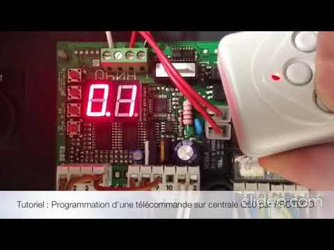

Hi maby somebodey can help with my gate control unit.
It is Proteco Q60A model. I have problem with adding new remote control. That should be easy, but control unit not recognize any radio signals from not programmed remote control.
i need to choose rA->tC then accept like in video.
But unit not recgonize new control unit. No dot appear
this -.- means known remote control signal reciving
this shuld be --. unknown remote control reciving
but in my case is -- completly not recgonize and not reciving remote control. I have 5 programmed remote control to this unit and they wroking. I want add 6 the same producer and same parameter of control unit but it not working.
Quick manual: https://www.scribd.com/document/4386...oteco-Gate-Q60
Only known solution is to remove all remote control's from memory, but if reciver will not see the fob's i will lost access to gate ;/
