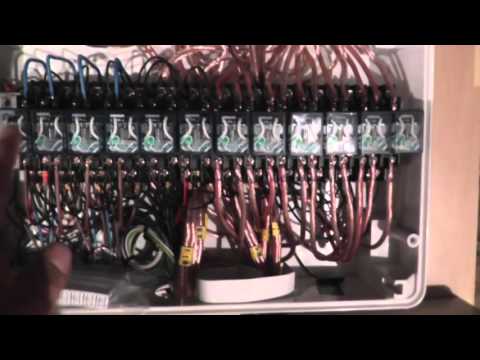

                  #38
                  Quick update!
                  After 3 sets of PC ATX power supplies, I upgraded the system to individual 12 and 5 volts power supplies.
                  The 5 volts its ok, the 12 volts,although I had it in consideration, I think I should have had measured the load of the system, as I think the power supply I bought is not quite up to the job.
                  Saying that, is working for nearly a year now, see how it goes.
                  The cause is that on top of the audio system, the 12v power supply, is also feeding the CCTV cameras, the network switch, my "Bathroom Automation System" (See my other posts...) etc...
                  Apart from the power supplies the whole system has been working faultlessly!
                  I am thinking of making a video to demonstrate the system in action...
                  Will post it here as soon as its done...

                    #39
                    Hi
                    As promised, below is the video that I have made, to show the system in action.
                    Hope you enjoy it!
