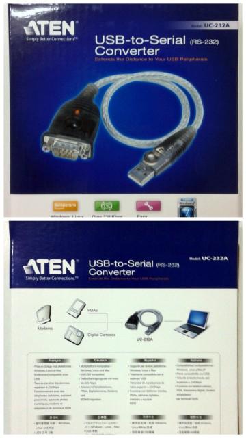

          First you need to buy 1 null modem cable (around $10) and 1 usb adapter (around $25). They can be bought from Sim Lim Square Level 5, just in front of the lift. (Shop Name : M Tech Source or Bizgram)
          Below is the picture of the 2 item
          Female to Female Null Modem Cable (Please note don't buy the wrong one. There is also a null cable in the market that look exactly the same. So you must specify to the salesperson, you wanted a Null Modem Cable)
          Aten USB to Serial Converter

            I have a USB to serial converter. Now i just need a null modem cable. But for my flickering issue at startup screen and not able to press anything on the remote. Is it a software issue or any hardware is damaged inside?

                              #15
                              if your usb adapter is not the above brand, then slim chance it will work
